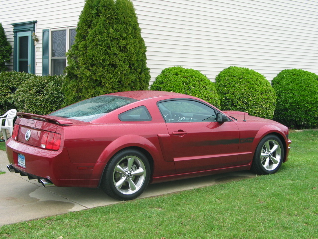

Wayne
PostPosted: Mon May 21, 2007 8:37 pm
thanks hare, nice cali special! i really like the front and rear fascias much more than the stock ones.
i had the suspension replaced and finally got rid of the suspension noises. BMR tubular Aarms; steeda shocks, struts, ball joints, endlinks, gtrac brace; adjustable swaybar from calistang; edelbrock strut tower brace, and more recently BMR relocation brackets and spohn poly/rod adjustable lower control arms. . . and would you believe i'm still not done!!!!!
this thing handles very well now. i like feeling the road and the tight suspension. i autocrossed twice now and this car is FUN!!!!!
are those the MAC mufflers on your car? and when you said three settings, do you mean the sway bar?
 Post subject: Mufflers
PostPosted: Tue May 22, 2007 9:07 am
Posts: 46
HI, the exhaust is Borla exhaust from the Ford Racing catalog that the dealer installed and it is the front sway bar that is adjustable. How you like your suspension now?..is it stiffer than the stock? Adjustable? I am not finished with mine either, but pretty broke now after all the FR parts I just had installed. Later, I plan on upgrading the motor with at least a more radical cam and tune...not sure about turbo or supercharging but as I visit more car club site, like the one in OC(Ocean City Cruise) over the weekend, which was awesome by the way, I like seeing what others have had success with. I found "Boss281" there, and his stage 3 cams sounded really nice, but he said he was still working the bugs out of the tune that the shop did. Where do you run the autocross? I would like to try that.
