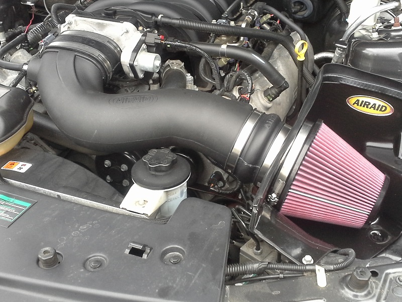

By the way, here is the Airaid installed on the Ghost!

I can't comment on the gas mileage because I haven't really checked it. I do feel an improvement in acceleration and Di says she can feel it too. As for how much improvement I don't have any numbers for it but it is noticeable. An engine will always run better when it breathes better. Thats why back in the day we always replaced the stock air cleaner with an Edelbrock or some other aftermarket open filter to let the engine breath better. At the very least, the lid to the stock air filter housing was inverted to allow more air in lol.
Right now I am running with the venturi insert installed in the inlet tibe which limits the additional airflow enough to keep the mass airflow sensor from going nuts and causing problems. I wont feel the full potential of the CAI until I get a tune on the car (which I hope happens very soon) and can remove the insert.
The Airaid CAI that I installed can be run without a tune with the venturi insert installed but there are several CAIs that are designed specifically to not require a tune, and as such tend to be less expensive. They have a smaller filter and inlet tube that prevents the above aforementioned excessive airflow problem from occurring. They do improve performance but the results are less than a CAI that has a larger inlet tube (which typically requires a tune). The CAIs can be run on regular 87 octane gas, it is the race tune that requires 93 octane or better. If nothing else, a CAI adds a deeper throatyness to the engine sound and they look badass when the hood is lifted lol.

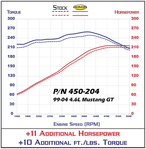

I am no expert on CAIs and only have the information I found online. Airaid states the typical gain with their CAIs is 10 to 15 hp. Not earth shattering but it is an increase. Attached are a couple of dyno run charts that Airaid presents on their web site. Jared from Airaid confirmed for me that the results are with no tune. I also found a dyno chart online for a C&L CAI without a tune. The dyno run with the C&L also shows about a 10 hp difference.
For what its worth.
Bruce

An increase of 10 or so more horsepower and torque would be noticeable in a 2006 GT. So if you go the tuner route you can change your engine to run more efficiently with even more air flow to boost your performance to around a 35 hp and torque increase over the stock settings.

Picked up a tuner for a really good price. Removed the insert from and the CAI and the Ghost got its first performance tune. Feels good. Haven't been able to stretch its legs like i want because of all the traffic but the low end power increase is very noticeable. Thanks Bob!
