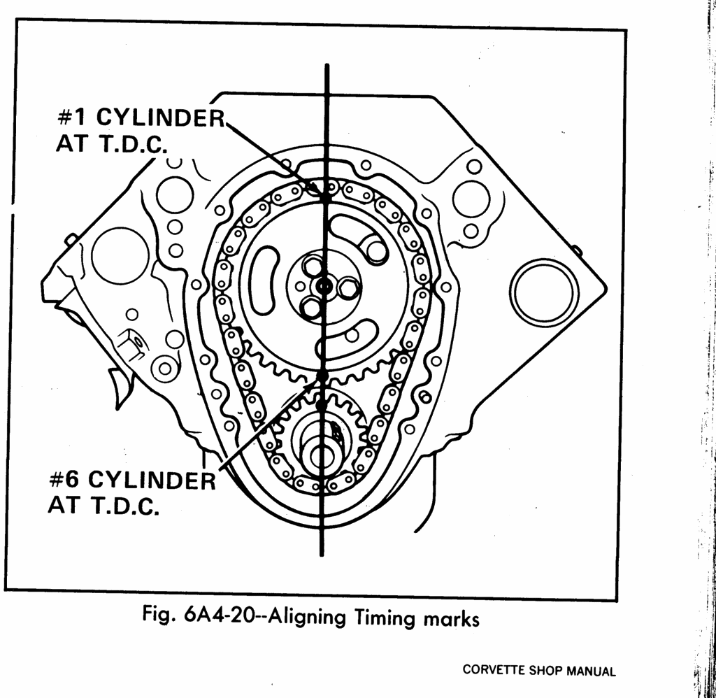

Question: I'm at 0 on the harmonic balancer (cylinder 1 @ TDC) if I turn the engine over to 0 again on the harmonic balancer, will I be at TDC for cylinder 6? I know I'll be on intake stroke for cylinder 1 but I'm interested in cylinder 6...

may help.. being I don't know what you are trying to do
