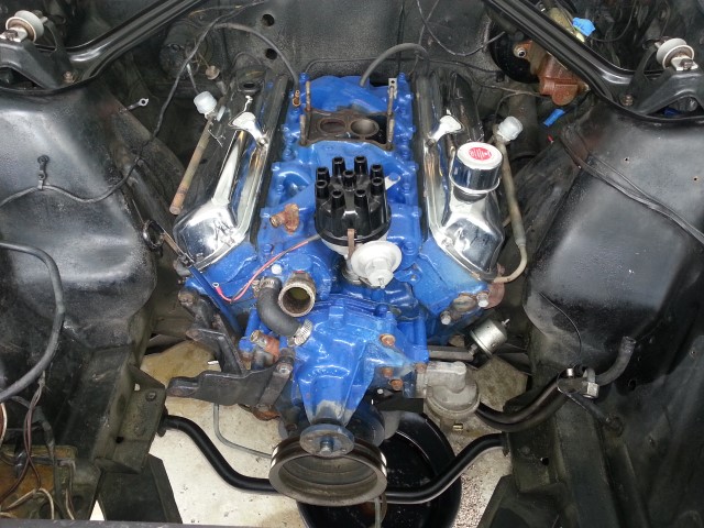

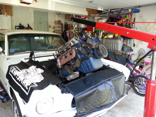

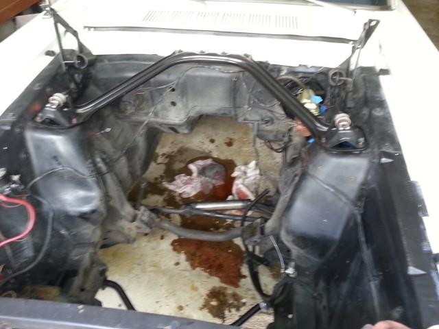

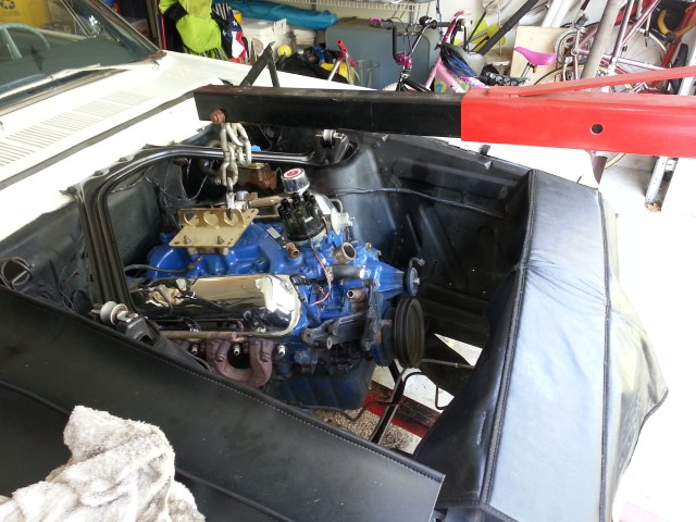

Engine and trans came out yesterday. Turns out this needed to be done. The rear main was leaking, the #7 cylinder was wet (the rest were burning a nice greyish tan), the starter was a bit chewed up, I had fuel pooled under the carb, and the trans was leaking from various locations. Now to clean up the engine bay....
Steve

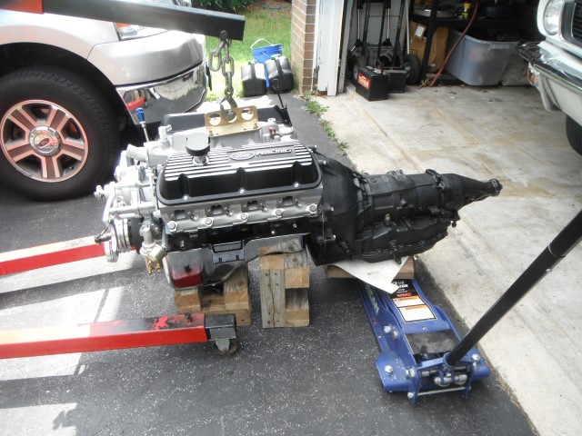

Posts: 57

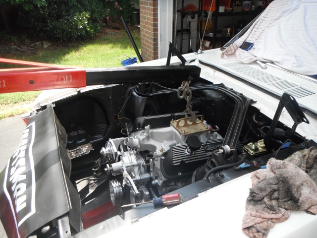

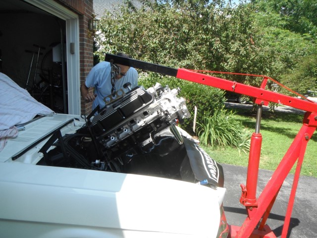

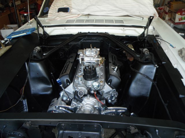

Update!!!
The new engine and trans went in today. Now to start with getting the rest of it in. Unfortunately, my ceramic coated tri-y's don't fit, they hit the bell housing on the passenger side. Any shorty header recommendations would be appreciated...
Steve
 Post subject: Re: Learnin' Time
PostPosted: Sat Jul 05, 2014 9:18 am
Looking really nice and you should be popping wheelies in no time. :3gears:

Well, I dropped the big bucks :yikes: and ordered a set of Sanderson Headers. They are configured to work with the AOD application so I shouldn't have any fitment issues.

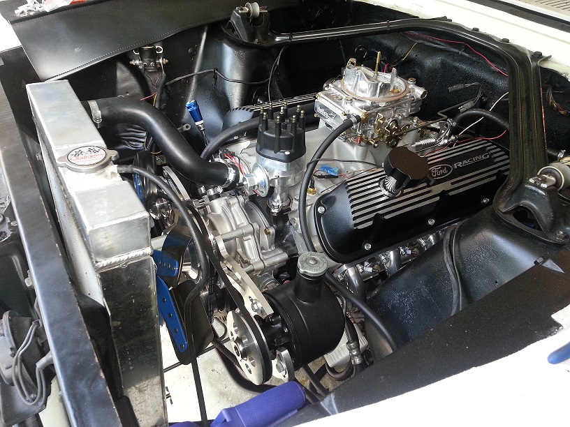

Update:

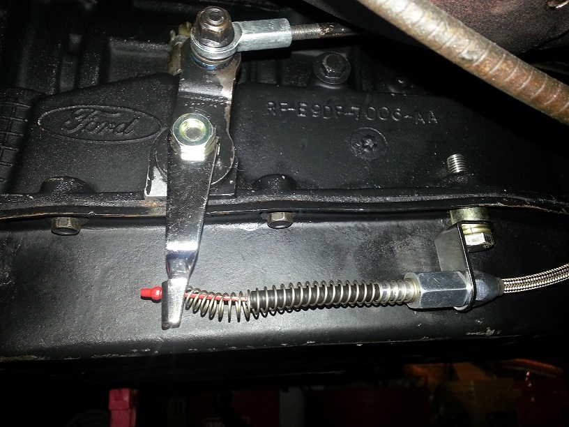

Just about ready to fire things up. I'll need a bit of help getting the ignition/wiring hooked (joys of being colorblind). Once the engine is running, I'll need to get the AOD dialed in and get the exhaust welded in (Magnaflows).
Can't wait to drive her again!!!

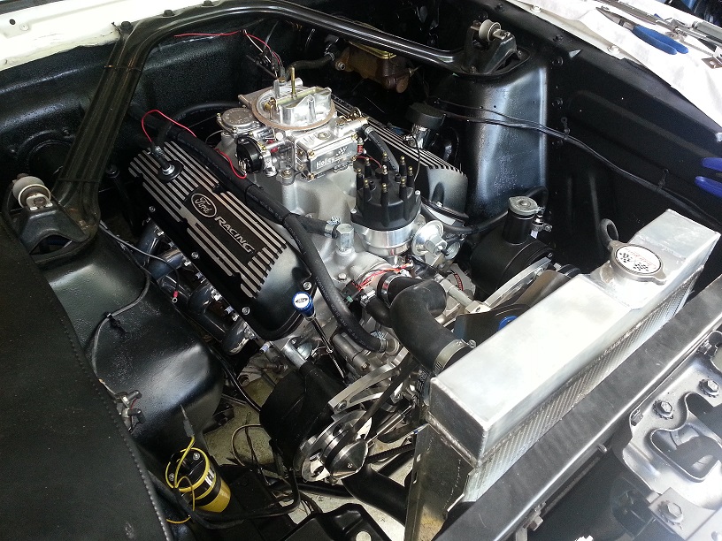

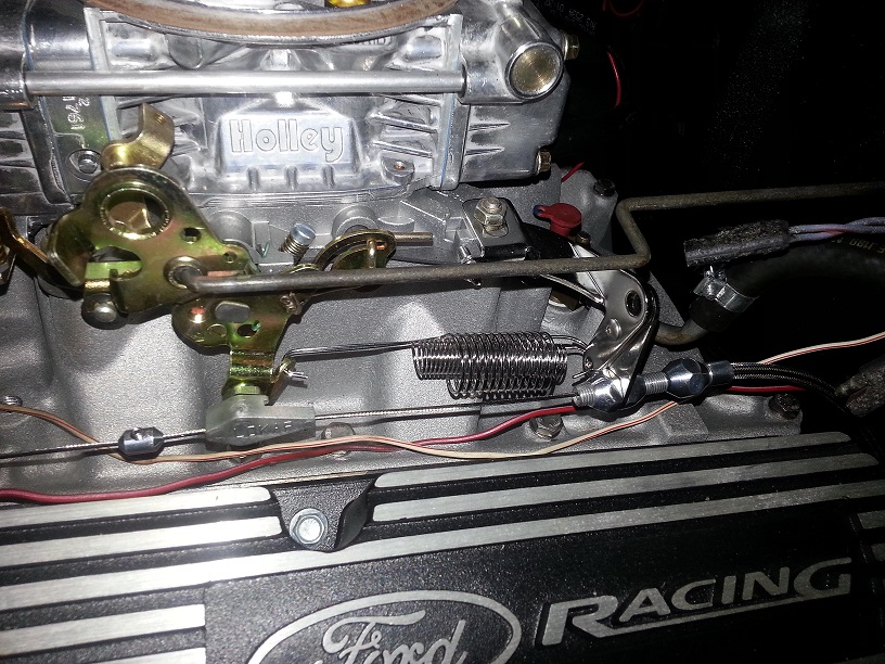

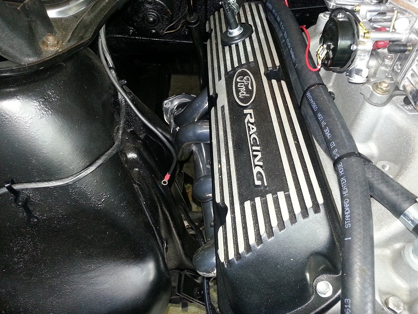

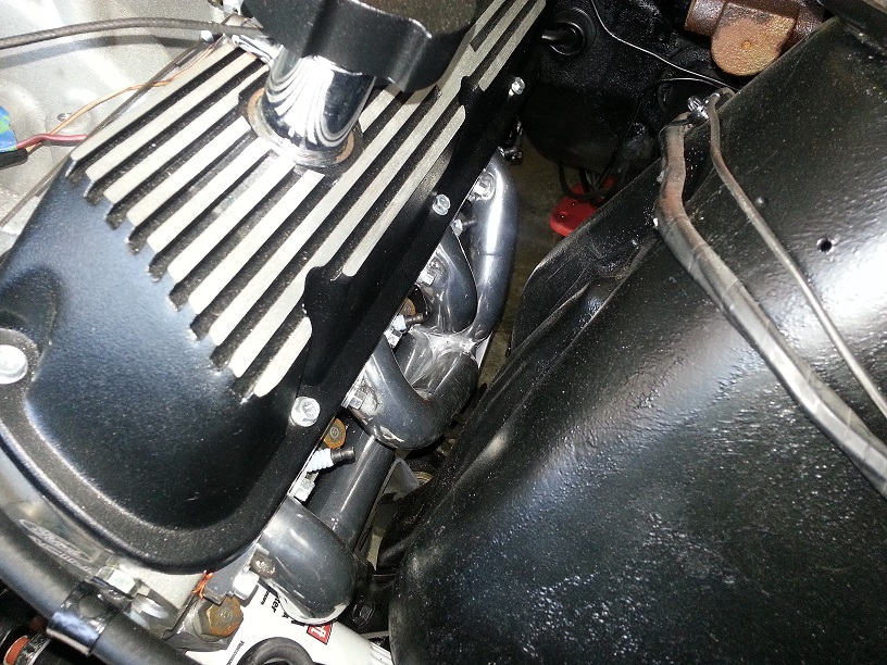

Here are some pics...

So close and yet so far. I am able to get the engine to turn over, but I have no spark. Unfortunately, I've reached the limit of my shade tree knowledge. Is there anyone out there with ignition know how willing to make a house call (Severn)??? My appreciation would definitely be properly expressed!!! :clinkmugs:
