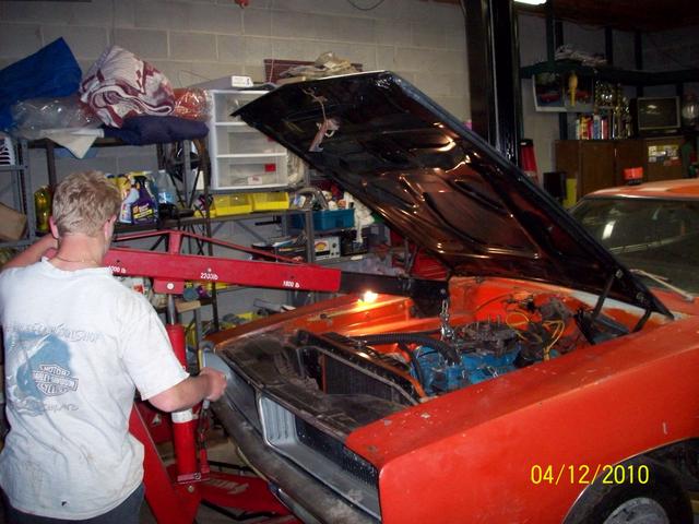

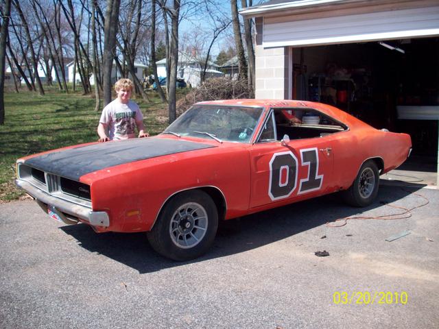

Awesome!! I thought my son was the only young-un getting into restoring these musclecars! Brian is now 17 and working on his 69 Charger whenever he gets the chance. He helped me a lot over the years with my 67 Shelby and others and he's hooked, too!
Congrats!! Great Work!!

File comment: His 69 Charger project

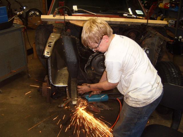

Kurt & I cut out two rust holes in the right side shock tower. They rusted where the aprons are pinched welded on. Then we cut some 16 gauge patches, using the old cut outs for templates. Then it was time for Kurt’s 1st welding job!
Thanks!
Pat
A little hammer & dolly work
Not bad for his 1st time! After a little grinding it will look great!
