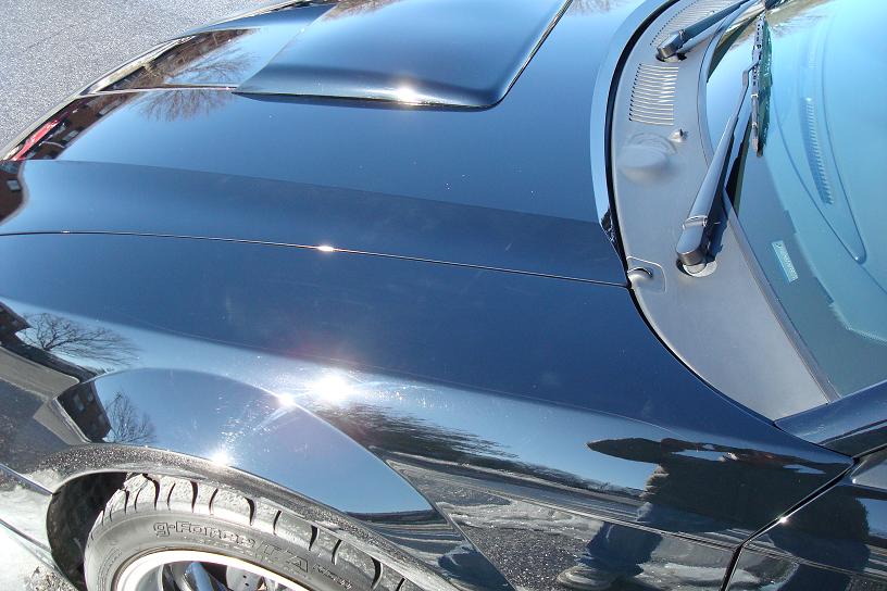

I took some pics today. All you can see is the hazing effect, it doesn't look 3D when I take a picture of it. The hazing is centered over where the hood meets the front pannel.

PostPosted: Sat Jan 31, 2009 11:19 pm
Yep it's just some swirls. I usually put the wax on with a buffer take it off after it hazes up then I wait and let it sit in the sun then go over it again with a fresh cloth.
