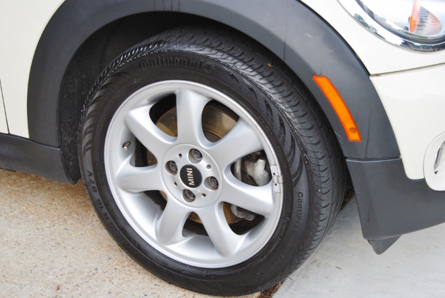

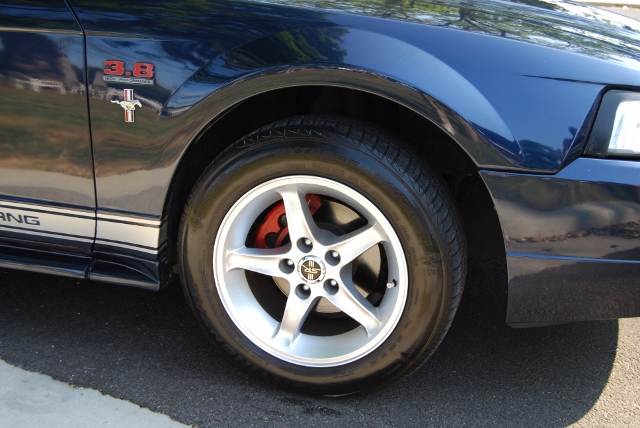

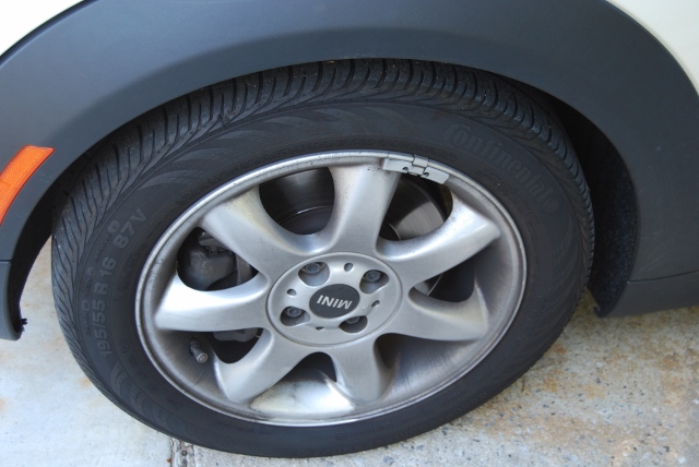

Here is a recent example of my 5 spoke aluminum Cobra R wheels that I purchased from American Muscle in 2008. Now aluminum will never be as bright as chrome, which I believe the Mothers Powerball System is better suited for, but the Mothers Powerball will get into the nooks and crannies to help with cleaning and polishing. But keep in mind that a polish is a mild abrasive and will not offer any protection to your wheels. That is why a wax or a paint sealant is necessary to protect the wheels from brake dust and other harmful pollutants. Just as you would not want to polish your car without adding a wax or paint sealant for protection, the same thing applies to your aluminum or chrome wheels.
I recently detailed my daughters 2010 Mini Cooper S. Mini uses a very soft brake pad which causes a tremendous amount of brake dust. Since detailing her car and applying Griot's Garage One-Step Paint Sealant to her wheels she has less noticeable brake duct accumulation and a simple hosing of the wheels removes most of the remaining brake dust.
I have also used the Mothers Powerball foam cleaning pads and after only one or two uses they become so dirty that you have to replace them. Not very economical.
I am enclosing a close up of my six year old wheels and a before and after photo of my daughters 2010 Mini Cooper S wheels.

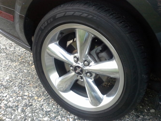

Were factory wheels ever clear coated? How is a way to determine if they are?
 Post subject: Re: Aluminum Wheel Care
PostPosted: Fri Oct 25, 2013 3:47 pm
Dave is absolutely right! Back in 2008 when I bought my 2002 Mustang it came with aluminum wheels but not a matched set. They were beat to death with a lot of scratches and peeling clearcoat. The clearcoat had turned yellow and made the wheels look horrible. I bought an aluminum polishing kit from a company called Busch at the Ford show at Carlisle. This aluminum polish was so strong that it made the peeling clearcoat even worse! :cussing: I even spoke with a wheel repair specialist who told me how expensive it would be to have the clearcoat removed.
At that point I decided that it was easier for me to just buy new wheels for the car which I did. The Mothers Powerball System is better suited to chrome finished wheels which in most cases are not clearcoated. I would have to say that most factory OEM wheels are clearcoated to offer them a measure of protection against pitting. If you want to use the Mothers Powerball system you can do so with a liquid cleaner/polish/wax. Mothers makes a product like this as does Meguiar's, Armor All, Turtle Wax, Black Magic, Simonize and many other companies.
It is just so much easier to use a car paint protectant cleaner/wax which is mildly abrasive and will not harm the clearcoat on your wheels. If it is safe enough to use on your cars paint than it is safe enough to use on the cars aluminum wheels. You can use a Caranuba based product or a synthetic product but both would be safer on your wheels. I use metal polish but not on my wheels.
