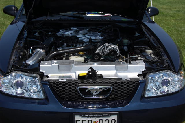

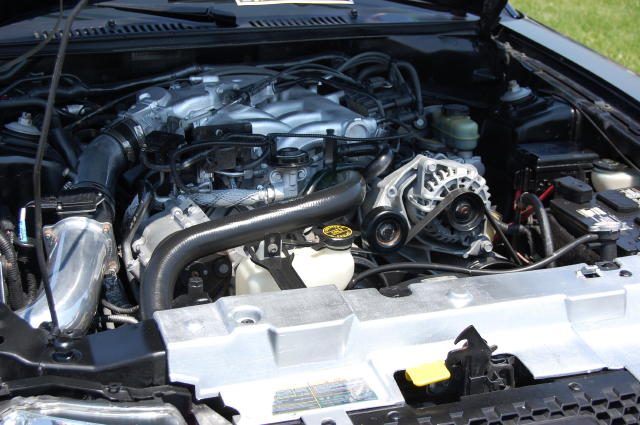

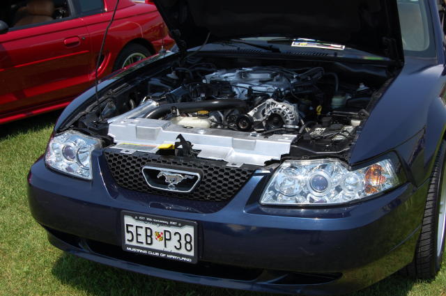

I actually take a lot of pride in cleaning and detailing my engine. It may not be a sexy V8 but it certainly looks better than the stock V6 and always gets a positive reaction from the spectators who attend the car shows.
Here are some photos of my engine.
