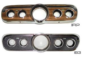

1. Instrument panel would have included the gauges instead of the "idiot" lamps:
a. 65 - this would have been an upgrade option.
b. 66 - all cars had gauges.
2. 1965 GT's had a unique amp gauge with a pass through amperage sensor. This is different than the standard 1965 Mustang amp gauge. All 1966 Mustangs have the same amp gauge that receives a charge/discharge signal from the voltage regulator.

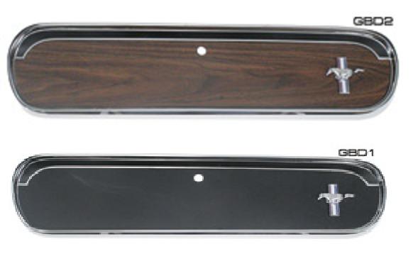

3. There were two different sets of instrument bezels and glove box doors that came on 1965 and 1966 Mustang GT's:
See Atachments
a. IB2 and GBD2 came on all 65-66 Mustangs with Deluxe Interior.
b. IB3 and GBD1 came on all 65-66 GT's with Standard Interior.

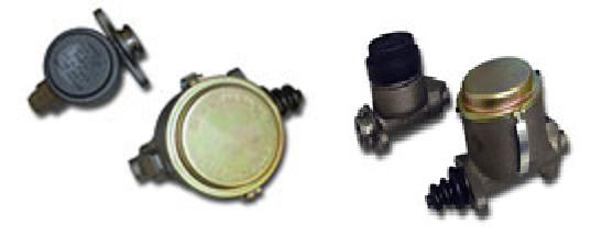

4. Mustangs with disc brakes had a much larger master cylinder then those with drum brakes. The pictures show the difference between the two master cylinders.
Master Cylinder Comparison 1 Master Cylinder Comparison 1
See Atachments
