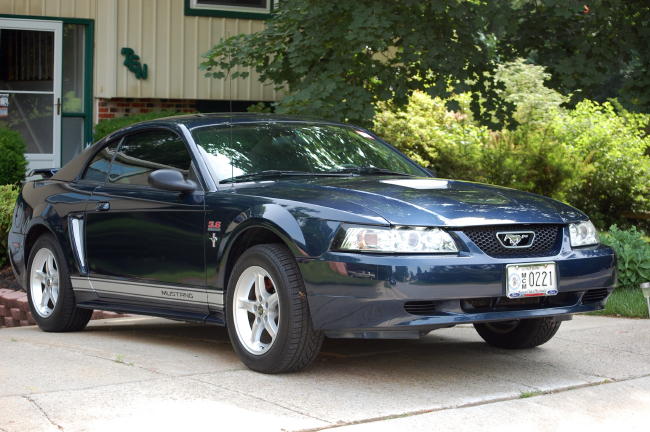

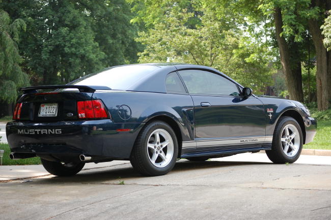

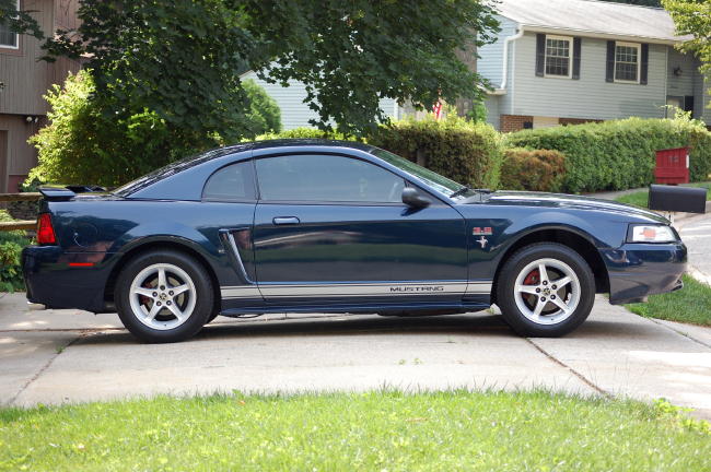

Now that I'm retired I can devote time to detailing cars which I enjoy. Here are some photos of my car, a 2002 V-6 Mustang after I clay barred and waxed it. My car was repainted last year so I did not need to polish it at this time as it has no swirl marks or oxidation.
My wife's 2008 Mercury Mariner is next to be detailed and I'll clay that and use paint sealant to protect the finish and offer a high gloss shine.
