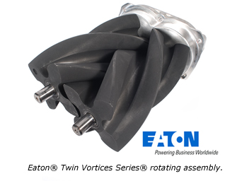

ROUSH’s supercharger line-up is more than just another collection of Roots-type blowers. The internals of the current ROUSH supercharger line-up feature EATON’s advanced TVS 2300 technology.
Here are some of the key features of this technology:
• The unique 160-degre-twist four-lobe rotors and high flow inlet and outlet port design provides enhanced thermal efficiency, higher volumetric capacity, and higher operating speeds. This design provides its enhanced air handling characteristics without increasing the overall size of the unit.
• The system is capable of running with a high thermal efficiency (up to 76%) across a very wide operating range, which enables more compact packaging and greater output.
• EATON TVS superchargers are capable of a 2.4 pressure ratio.
